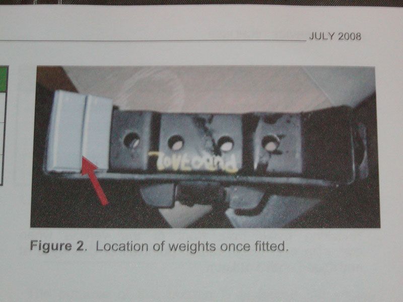

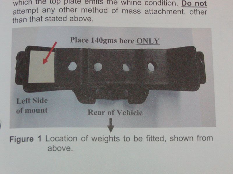

    Harmonics issue, originally the fix back in 2008 was to attach wheel weights to the trans mount to alter the natural frequency of the assembly. New design trans mount (if available) would cure this also.
